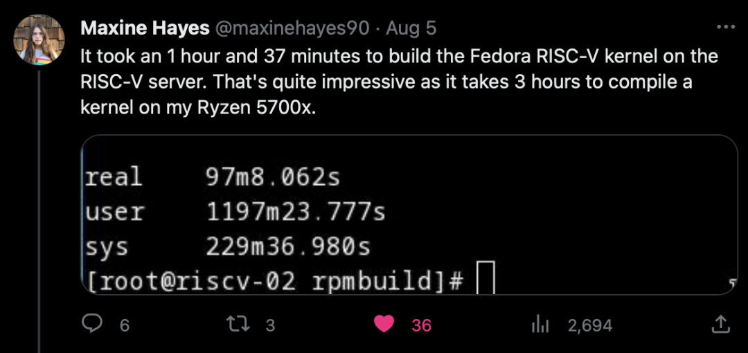

注释:编译Fedora,HS-2 64核RISC-V服务器比Ryzen5700x快两倍!

Once I restarted the build I sat and waited again for about 20 minutes to see if I would run into another error. When I was sure there wouldn't be the possibility of an error I walked away
and came back the next day to find it build without any issues! To my surprise the build took 1 hour and 37 minutes to complete!
