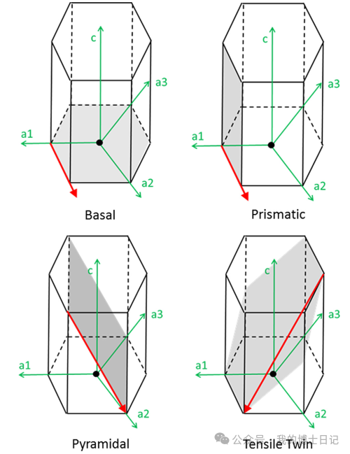

适合HCP mg合金的黄永刚umat的晶体塑性
参考文献:《Computational micromechanics of bioabsorbable magnesium stents》
适合HCP mg合金的黄永刚umat的晶体塑性的图1
文章的子程序中考虑了孪晶的影响,感兴趣的可以下载调试。子程序如下(部分子函数可以参考):

c----- generating slip directions and normals for hcp-basal
rwkdir = 0.
rwknor = 0.
angle = acos(-1.)/3.
cangle = cos(angle)
sangle = sin(angle)
rwkdir(1,1) = 1.
rwkdir(2,1) = 0.
rwkdir(1,2) = cangle
rwkdir(2,2) = sangle
rwkdir(1,3) = -cangle
rwkdir(2,3) = sangle
rwknor(3,1) = 1.
rwknor(3,2) = 1.
rwknor(3,3) = 1.
do i = 1,3
do k = 1,3
slpdir(k,i) = rwkdir(k,i)
slpnor(k,i) = rwknor(k,i)
enddo
enddo
c----- generating slip directions and normals for hcp-prismatic
rwknor = 0.
rwknor(1,1) = 0.
rwknor(2,1) = -1.
rwknor(1,2) = sangle
rwknor(2,2) = -cangle
rwknor(1,3) = -sangle
rwknor(2,3) = -cangle
do i = 4,6
do k = 1,3
slpdir(k,i) = rwkdir(k,i-3)
slpnor(k,i) = rwknor(k,i-3)
enddo
enddo
endif
if(ictype >= 3)then

if(ictype == 4)then
c ###### twinning planes #####
c slip directions
do j = 1,6
rwkdir(3,j) = aspect
enddo
rwkdir(1,1) = 0.
