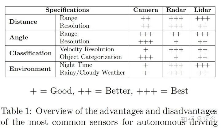

关于传感器融合,特别是摄像头、激光雷达和雷达的前融合和和特征融合,是一个引人注意的方向。

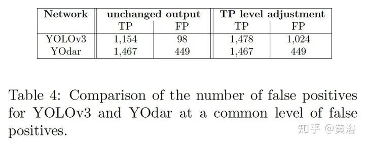

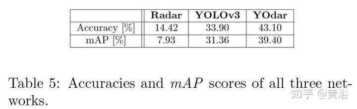

1 “YOdar: Uncertainty-based Sensor Fusion for Vehicle Detection with Camera and Radar Sensors“, 11,2020
基于不确定性的融合方法。后处理采用gradient boosting,视觉来自YOLOv3,雷达来自1D segmentation network。

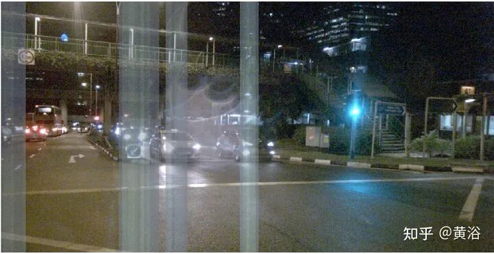

几个摄像头和雷达融合的目标检测方法的图3
Image of a radar detection example with four predicted slice bundles

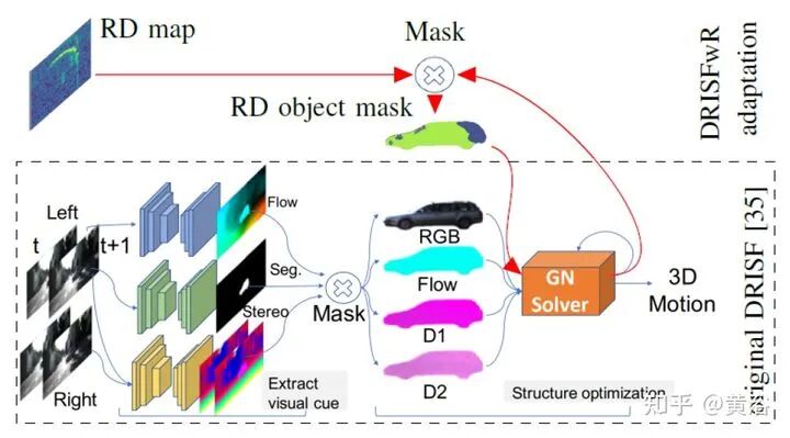

几个摄像头和雷达融合的目标检测方法的图8
DRISFwR overview (deep rigid instance scene flow with radar)
Automatic scene flow alignment to Radar data via DRISFwR:

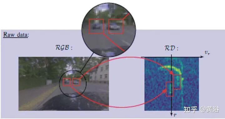

几个摄像头和雷达融合的目标检测方法的图9
RGB image and RD-map with two vehicles

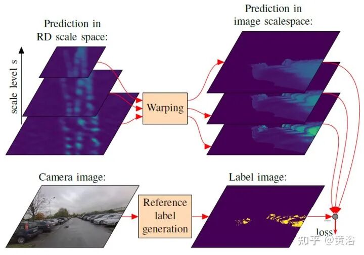

RD-map warping into camera image:
几个摄像头和雷达融合的目标检测方法的图12
Loss in scale-space:
几个摄像头和雷达融合的目标检测方法的图13

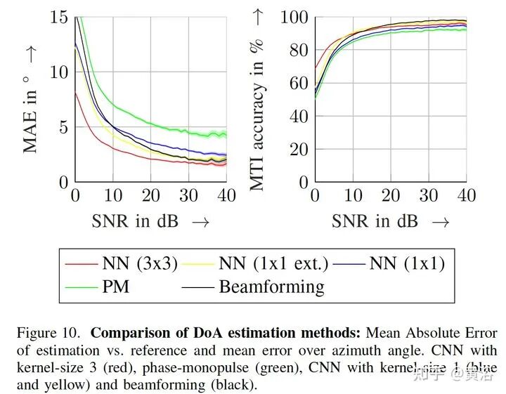

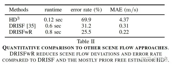

最后实验结果比较:
几个摄像头和雷达融合的目标检测方法的图14
几个摄像头和雷达融合的目标检测方法的图15
几个摄像头和雷达融合的目标检测方法的图16

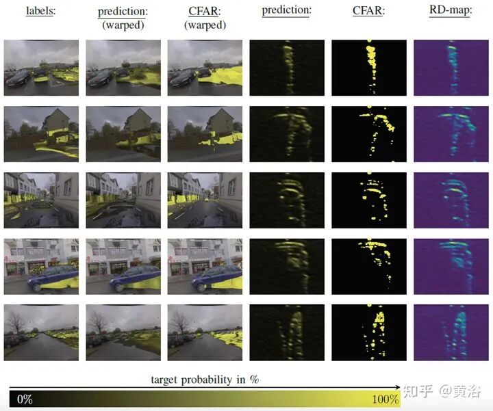

Qualitative results of target detection on test data examples
几个摄像头和雷达融合的目标检测方法的图17
Qualitative results of semantic segmentation on test data examples

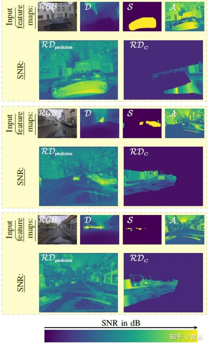

Qualitative results of SNR prediction on test data:
几个摄像头和雷达融合的目标检测方法的图19

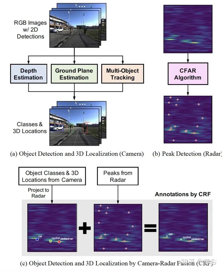

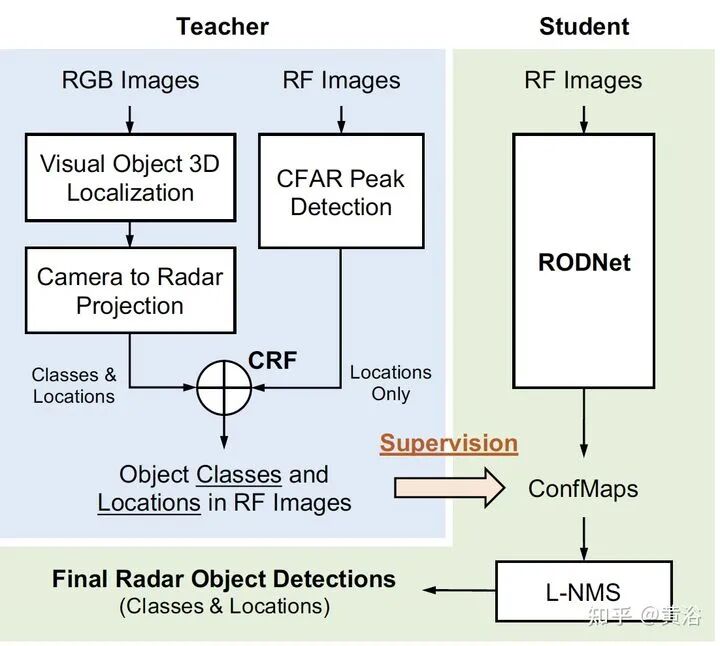

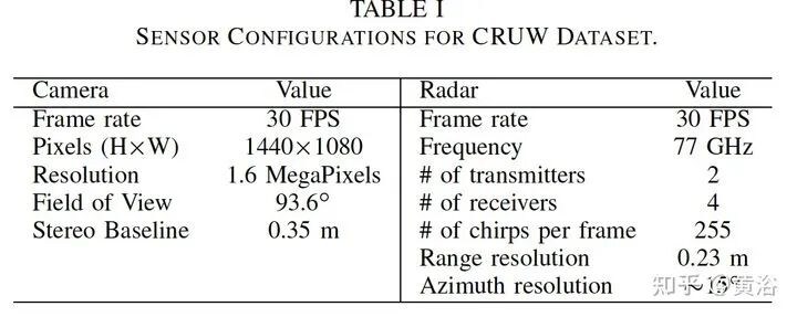

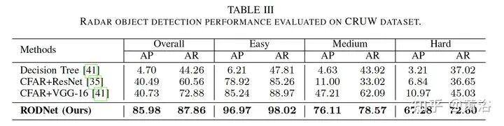

3 "RODNet: A Real-Time Radar Object Detection Network Cross-Supervised by Camera-Radar Fused Object 3D Localization", 2 2021
雷达目标检测网络RODNet,但训练是通过一个摄像头-雷达监督算法,无需标注,可实现射频(RF)图像的实时目标检测。原始毫米波雷达信号转换为range-azimuth坐标的RF图像;RODNet预测雷达FoV的目标似然性。两个定制的模块M-Net和temporal deformable convolution分别处理multi-chirp merging信息以及目标相对运动。训练中采用camera-radar fusion (CRF) 策略,另外还建立一个新数据集CRUW1。
几个摄像头和雷达融合的目标检测方法的图20
cross-modal supervision pipeline for radar object detection in a teacher-student platform

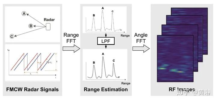

几个摄像头和雷达融合的目标检测方法的图21
workflow of the RF image generation from the raw radar signals

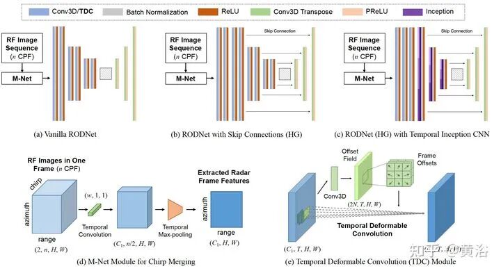

几个摄像头和雷达融合的目标检测方法的图22
The architecture and modules of RODNet
几个摄像头和雷达融合的目标检测方法的图23
Three teacher’s pipelines for cross-model supervision

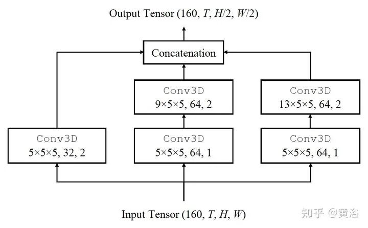

几个摄像头和雷达融合的目标检测方法的图26
temporal inception convolution layer

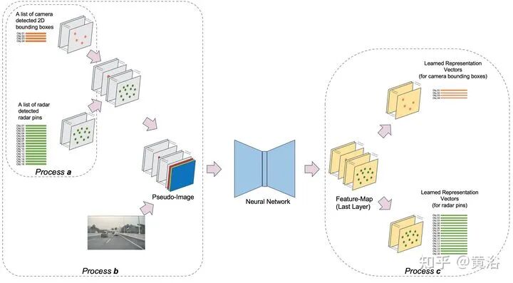

重点讨论data association问题。而rule-based association methods问题较多,故此讨论radar-camera association via deep representation learning 以开发特征级的交互和全局推理。将检测结果转换成图像通道,和原图像一起送入一个深度CNN模型,即AssociationNet。另外,设计了一个loss sampling mechanism 和 ordinal loss 来克服不完美的标注困难,确保一个类似人工的推理逻辑。
几个摄像头和雷达融合的目标检测方法的图28
associations between radardetections (radar pins) and camera detections (2D bounding boxes).
几个摄像头和雷达融合的目标检测方法的图29
AssociationNet

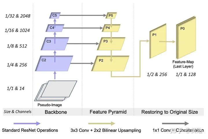

几个摄像头和雷达融合的目标检测方法的图30
architecture of the neural network

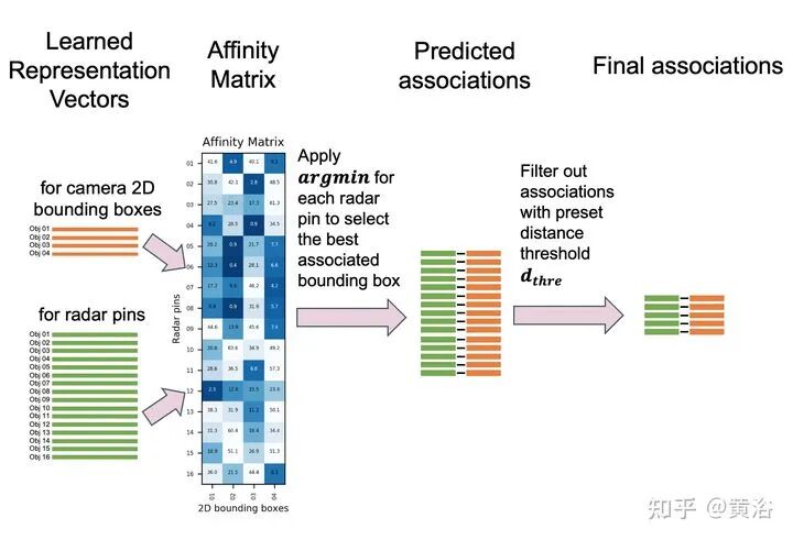

几个摄像头和雷达融合的目标检测方法的图31
process of obtaining final associationsfrom the learned representation vectors

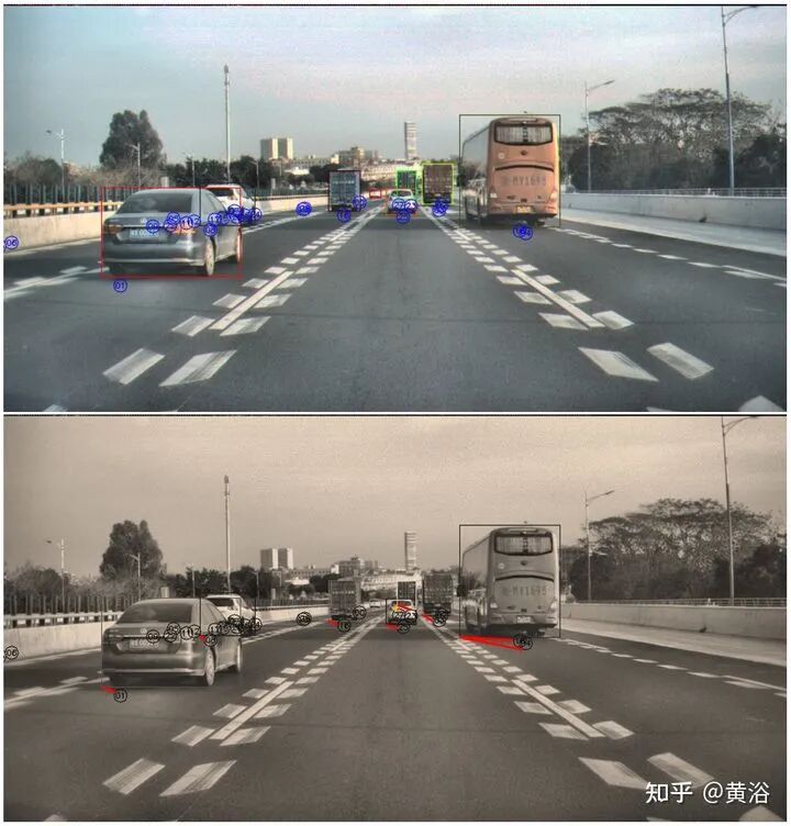

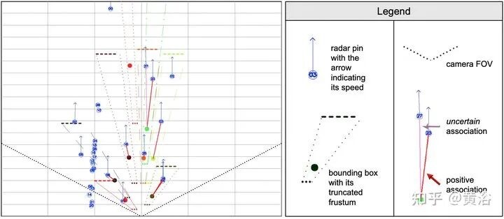

几个摄像头和雷达融合的目标检测方法的图32
illustration of radar pins, bounding boxes, and association relationships under BEV perspective
几个摄像头和雷达融合的目标检测方法的图33
几个摄像头和雷达融合的目标检测方法的图34
the red solid lines represent the true-positive associations; and the pink solid lines represent predicted positive associations but labeled as uncertain in the ground-truth
几个摄像头和雷达融合的目标检测方法的图35
The added green lines represent the false-positive predictions; and the added black lines represent the false-negative predictions
