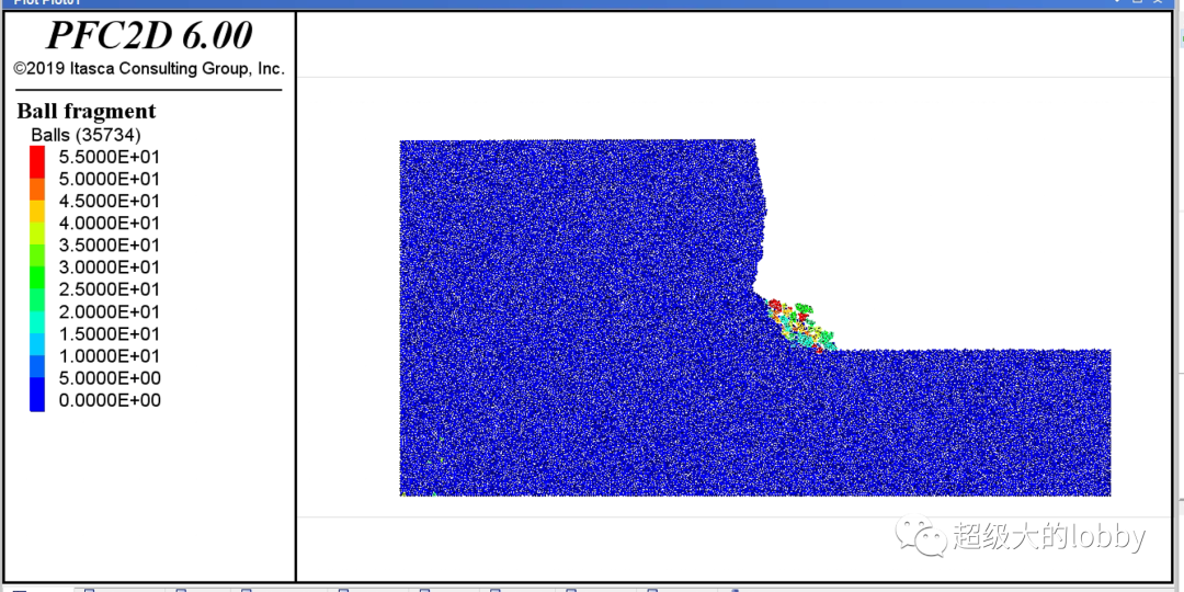

7、岩质边坡破坏
    这里的工况是在第十次计算就发生了破坏,破坏发生在坡脚。不做具体的分析。

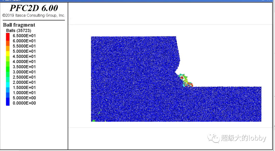

8、含软弱层岩质边坡破坏
    很多岩质边坡由于沉积和构造的作用,会是互层的。互层必然会是有软弱的层,有坚硬的层。
    这里的技术方法是先对颗粒进行分组。这里也是使用plane关键词,不过不是用半平面的概念,而是用distance来构造某一长条区域。然后对此组颗粒赋予较弱的属性。
model restore "yuya"
[jianju=keli_rdmax*10][kuandu=keli_rdmax*3][jiaodu=30]ball group "ying" ball group "ruan" range plane origin 0 0 dip [jiaodu] distance [kuandu*0.5]def add_ruan_up    pos_x=0    pos_y=0    loop while pos_x<wlx*0.5        pos_x+=(jianju+kuandu)*math.cos(jiaodu*math.pi/180.0)        pos_y+=(jianju+kuandu)*math.sin(jiaodu*math.pi/180.0)        command            ball group "ruan" range plane origin [pos_x] [pos_y] dip [jiaodu] distance [kuandu*0.5]        endcommand    endloopend@add_ruan_up
def add_ruan_down    pos_x=0    pos_y=0    loop while pos_x>-wlx*0.5        pos_x-=(jianju+kuandu)*math.cos(jiaodu*math.pi/180.0)        pos_y-=(jianju+kuandu)*math.sin(jiaodu*math.pi/180.0)        command             ball group "ruan" range plane origin [pos_x] [pos_y] dip [jiaodu] distance [kuandu*0.5]        endcommand    endloopend@add_ruan_down
[pb_coh=12.196e6][ten_coh=2.7][emod=2.114e9]
contact cmat default type ball-facet model linear method deformability ...            emod @emod kratio 1.5
[pb_coh=12.196e6][ten_coh=2.7][emod=2.114e9]contact cmat default type ball-facet model linear method deformability emod @emod kratio 1.5contact cmat default type ball-ball model linearpbond method deformability ...            emod @emod kratio 1.5 pb_deformability emod @emod kratio 1.5 ...    property pb_coh [pb_coh] pb_ten [pb_coh*ten_coh] pb_fa 45.7 fric 0.1    contact cmat add 1 model linearpbond method deformability ...            emod @emod kratio 1.5 pb_deformability emod @emod kratio 1.5 ...    property pb_coh [pb_coh] pb_ten [pb_coh*ten_coh] pb_fa 45.7 fric 0.1 range group "Default=ying" match 2contact cmat add 2 model linearpbond method deformability ...            emod [emod*0.2] kratio 1.5 pb_deformability emod [emod*0.2] kratio 1.5 ...    property pb_coh [pb_coh*0.2] pb_ten [pb_coh*ten_coh*0.2] pb_fa 45.7 fric 0.1 range group "Default=ruan" match 2
   contact cmat applymodel clean
model cycle 1model solve
contact method bond gap [keli_rdmin*0.5]
model cycle 1 model solve
model save "jiajiaojie"
下图为加完软弱层后的岩体。
【PFC6.0】重力放大法诱导分析岩质边坡破坏面的图2

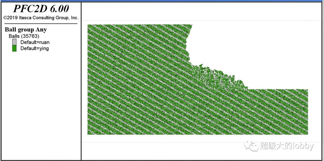

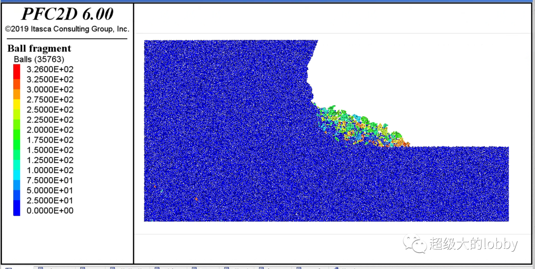

后续的代码和完整岩质边坡一模一样,这里给出最后的破坏图:
【PFC6.0】重力放大法诱导分析岩质边坡破坏面的图3
【PFC6.0】重力放大法诱导分析岩质边坡破坏面的图4
    上图为典型的顺倾岩层,可以看到和完整的岩质边坡相比,其反应的特性更加弱一点。

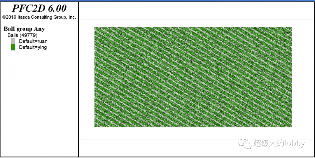

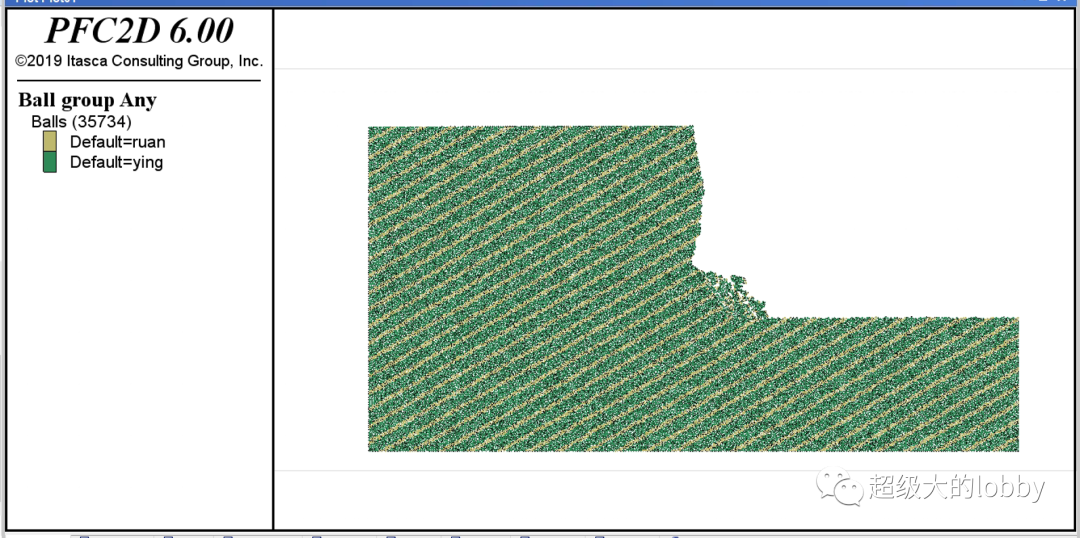

    下图为反倾岩层的破坏模式。可以发现反倾岩层相对于顺倾岩层,其拥有更高的稳定性。
【PFC6.0】重力放大法诱导分析岩质边坡破坏面的图5
