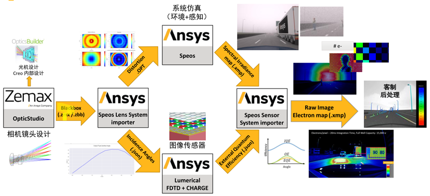

-Lumerical FDTD– Advanced optics and Multiphysics.
-Lumerical CHARGE– Charge collection, electrical noise.
-SPEOS – Ray tracing and optical system.
-OptiSLang – Orchestrate complex interplay of solvers and map the results together.
-Zemax – Powerful Lens design tool.
-Pervasive workflow that includes optical physics, system level optics, and electronics effects for accurate synthetic images.
-Prototype, understand and iterate on different imaging scenarios and modalities, experiment with image processing and computer vision algorithms in pre-production.
-Can save sensor and lens selection time for at least 2 months; sensor changing period at least 1 year and lens changing period for 3months

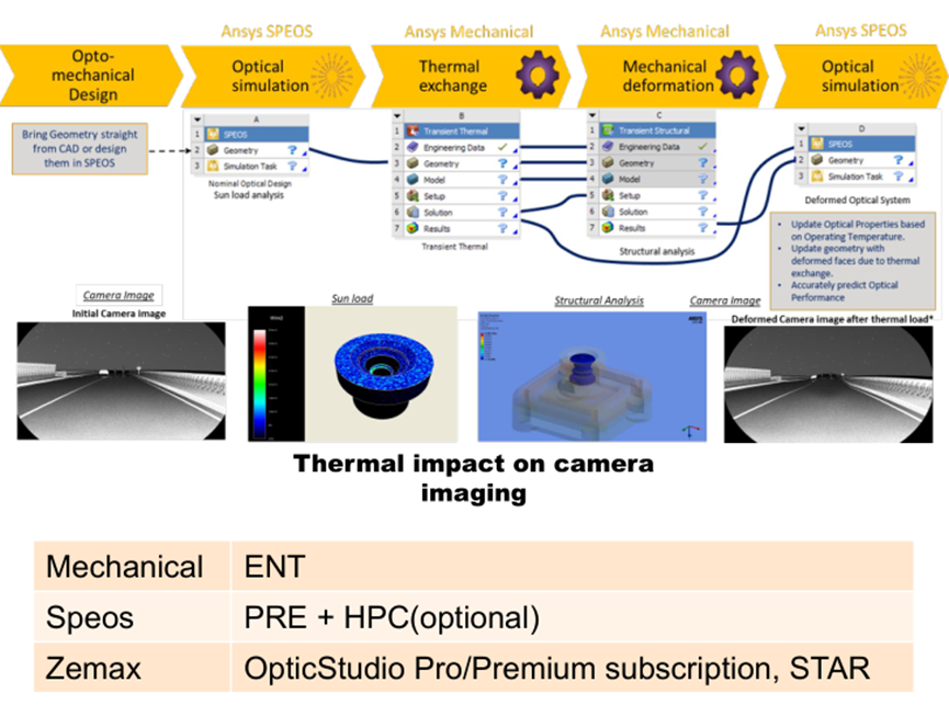

Multiphysics Workflow for
Structural-Thermal-Optical
-The working environment and temperature may cause the displacement and deformation of the lens and mechanism of camera, then affect the imaging quality
-Thermal stability of the lens system should be analyzed and optimized in the design stage.
-Ansys has multi-physics solutions that can cover the lens STOP analysis.
-In Ansys Workbench, the deformation of optical system under certain temperature or radiation load is analyzed by Mechanical, the influence of displacement and deformation on imaging is analyzed by Speos, and then the lens design is optimized by Zemax.
-Establish the workflow of optical system design, multi-physics simulation and optimization.
-Accelerate product design, verification and optimization.
-Improve product reliability.

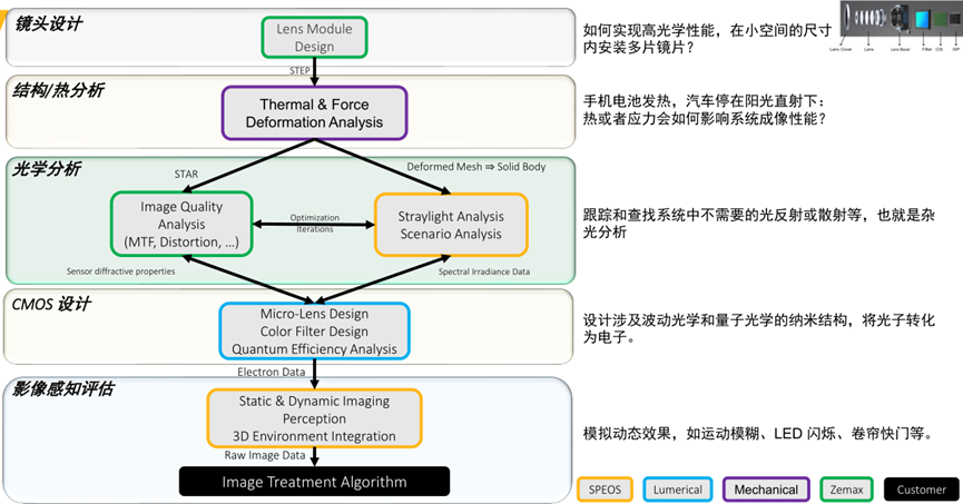

Stray Light Analysis
-Ana
lyze the stray light caused by multiple reflections between optical surfaces and reflection and scattering of non-optical surfaces, locate the stray light and eliminate it.
-Analyze the stray light caused by the reflection of CMOS micro lens.
-Ansys has a comprehensive optical solution including wave optics, sequence optics and geometrical optics.
-Zemax for Lens design, image quality analysis and system optimization.
-Speos for ray tracing and stray light analysis.
-Use Lumerical to obtain the scattering of CMOS micro lens, use Speos for imaging simulation.
-Establish a complete workflow of optical system from design, simulation, analysis to optimization.
-Improve the efficiency of optical system development and can save sensor and lens selection time for at least 2 months; sensor changing period at least 1 year and lens changing
period for 3months.
