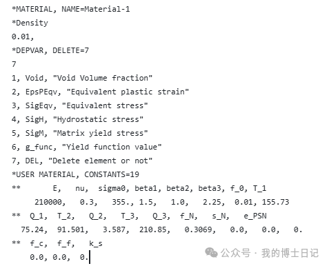

GTN 模型参考vumat
   subroutine vumat(
! Read only -
   .  nblock, ndir, nshr, nstatev, nfieldv, nprops, lanneal,
   .  stepTime, totalTime, dt, cmname, coordMp, charLength,
   .  props, density, strainInc, relSpinInc,
   .  tempOld, stretchOld, defgradOld, fieldOld,
   .  stressOld, stateOld, enerInternOld, enerInelasOld,
   .  tempNew, stretchNew, defgradNew, fieldNew,
! Write only -
   .  stressNew, stateNew, enerInternNew, enerInelasNew)
   include 'vaba_param.inc'
   DIMENSION PROPS(NPROPS), DENSITY(NBLOCK), COORDMP(NBLOCK),
   . CHARLENGTH(NBLOCK), STRAININC(NBLOCK, NDIR+NSHR),
   . RELSPININC(NBLOCK, NSHR), TEMPOLD(NBLOCK),
   . STRETCHOLD(NBLOCK, NDIR+NSHR),DEFGRADOLD(NBLOCK,NDIR+NSHR+NSHR),
   . FIELDOLD(NBLOCK, NFIELDV), STRESSOLD(NBLOCK, NDIR+NSHR),
   . STATEOLD(NBLOCK, NSTATEV), ENERINTERNOLD(NBLOCK),
   . ENERINELASOLD(NBLOCK), TEMPNEW(NBLOCK),
   . STRETCHNEW(NBLOCK, NDIR+NSHR),DEFGRADNEW(NBLOCK,NDIR+NSHR+NSHR),
   . FIELDNEW(NBLOCK, NFIELDV), STRESSNEW(NBLOCK,NDIR+NSHR),
   . STATENEW(NBLOCK, NSTATEV), ENERINTERNNEW(NBLOCK),
   . ENERINELASNEW(NBLOCK)
   CHARACTER*8 CMNAME
!  Internal VUMAT variables
   REAL*8, PARAMETER :: PI = 3.1415927
   parameter ( zero = 0.d0, one = 1.d0, two = 2.d0,
   . third = 1.d0 / 3.d0, half = 0.5d0, op5 = 1.5d0)
   REAL*8 SigDevOld(6)     ! Old deviatoric stress
   REAL*8 SigDevNew(6)     ! New deviatoric stress
   REAL*8 kappa, Eff_Void
   REAL*8 stresstr(6)
!  Read parameters from ABAQUS material card
   YOUNG = props(1)   ! Elastic/Youngs Modulus (e.g: E=210MPa for steel)
   POISS = props(2)   ! Poisson's ratio (often: \mu=0.33)
   SIGMA0 = props(3)   ! Initial Yield stress (at EpsPEqv=0)
   BETA1 = props(4)   ! Modified Gursons 1st constant: q_1
   BETA2 = props(5)   ! Modified Gursons 2nd constant: q_2
   BETA3 = props(6)   ! Modified Gursons 3rd constant: q_3
   TOL  = props(8)   ! TOLerance on the plastic return mapping
   MXITER = props(9)   ! Maximum number of iterations in the return map
   T_1  = props(10)  !
   Q_1  = props(11)  ! 3 term Voce hardening rule...
   T_2  = props(12)  ! T_i * (1 - EXP(-Q_i*EpsPEqv))
   Q_2  = props(13)  ! ... "" ...
   T_3  = props(14)
   Q_3  = props(15)
   FN  = props(16)  ! f_N, the volume fraction of void nucleating particles.
   SN  = props(17)  ! S_N, i.e the standard deviation in the nucleation distribution.
   EPSN = props(18)  ! \epsilon_N, i.e mean plastic strain for the distribution.
   f_c  = PROPS(19)  ! Void volume fraction upon which coalescence occurs.
   f_f  = PROPS(20)  ! Critical void volume fraction upon which failure occurs.
   k_s  = PROPS(21)  ! Shear damage term, k_s=0 means no contribution
!  Compute elasticity matrix
   G   = 0.5*YOUNG/(1.0+POISS)
   K   = YOUNG/(3.0*(1.0-2.0*POISS))
! Elastic constants:
   twomu = YOUNG / ( one + POISS )
   alamda = POISS * twomu / ( one - two * POISS )
   thremu = op5 * twomu

材料卡片
GTN 模型参考vumat的图1
