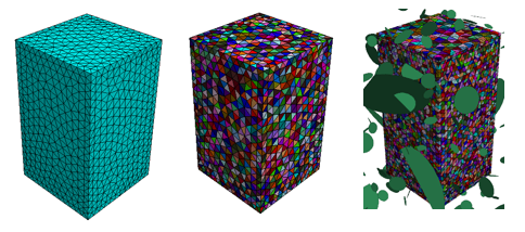

在这个例子中,首先产生一个brick, 然后划分单元,block zone list poly命令将每个单元转化为block,写入poly.dat文件。
block create brick -3 3 -3 3 -5 5block zone generate edgelength 0.5block zone list poly
新产生一个DFN,然后导入上面生成的poly.dat, 产生出BBM.
model domain extent -6 6 -6 6 -10 10fracture template create 'dfn1' size power-law 3 size-limit 0.5 10fracture generate template 'dfn1' dfn 'realization_1' fracture-count 200program call 'poly'block cut dfn name 'realization_1' jointset-id 99block zone gen edgelength 0.25
将单元zone转化为四面体tetrahedron---block zone list poly (BBM)的图1

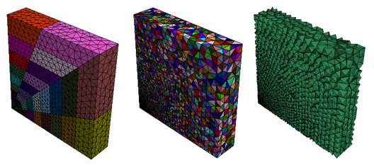

在这个例子中,首先产生一个tunnel,然后考虑到圆心巷道的对称,取其1/4部分划分单元,block zone list poly命令将每个单元转化为block,写入poly.dat文件。
block create tunnel length -1 1 blocks-radial 8 blocks-tangential 2 ...  boundary 8 radius-ratio 1.1block delete range position-x -100 0block delete range position-z -100 0block zone generate center 0 0 0 edgelength-center 0.1 distance 9 ...  edgelength-distance 0.5block zone list poly
导入上面生成的poly.dat, 这个导入过程需要占用输入一组节理,产生出BBM。
program call 'poly'block cut joint-set dip 30 dip-direction 90 spacing 0.5 number 20 ...  jointset-id 999block zone generate center 0 0 0 edgelength-center 0.1 distance 9 ...  edgelength-distance 0.5
将单元zone转化为四面体tetrahedron---block zone list poly (BBM)的图2
