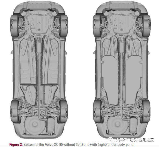

2 Building the CFD Model
Traditionally, at Volvo Cars two meshing programs were used. ICEM-CFD for an Octree mesh for the upper body, and TGrid for an unstructured Delaunay mesh for the under body. Today, meshing is done consequently with Harpoon from CEI, an octree mesher, which generates a hex-dominant mesh. To evaluate the influence of the two different meshes on the simulation results, two variants of the SUV Volvo XC 90 (with and without under body panels (UBP), Figure 2were calculated. It is an exterior model with rear view mirrors, fully detailed under body, fairly detailed engine compartment and open rim wheels.

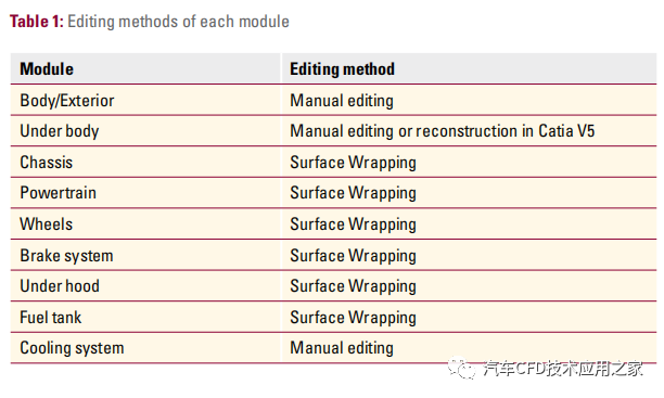

2.2 CAD Data Clean-up
For the clean-up of the CAD data – simplifying, removal of gaps and intersections – different methods are used, dependent of the content of the module. The biggest time savings can be achieved by using surface wrapping. With this method the base geometry is shrinked with a surface mesh. Holes will be closed, intersections removed and, if needed, geometrical details can be removed. Theoretically, the whole model could be generated with surface wrapping. Practically, the meshes become too big and the numerous surfaces cannot be handled very well in Ansa. Usually, a mixture of surface wrapping und manual editing is used, Table 1:
– Body/Exterior: unnecessary details in the exterior surfaces are removed and gaps are closed manually with Ansa.
– Front and rear chassis, engine and wheels: Simplifing and correction with surface wrapping. The wrapper of CD-Adapco is executed in the batch modus via a fitting script

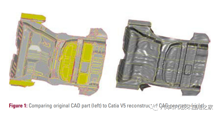

– Under body: generation of a continuous tessalated surfaces. Based on this construction of new surfaces in Catia V5. Hundreds of surfaces are reduced to ten.
– Cooling system: manual cleanup by the thermodynamic CFD team.

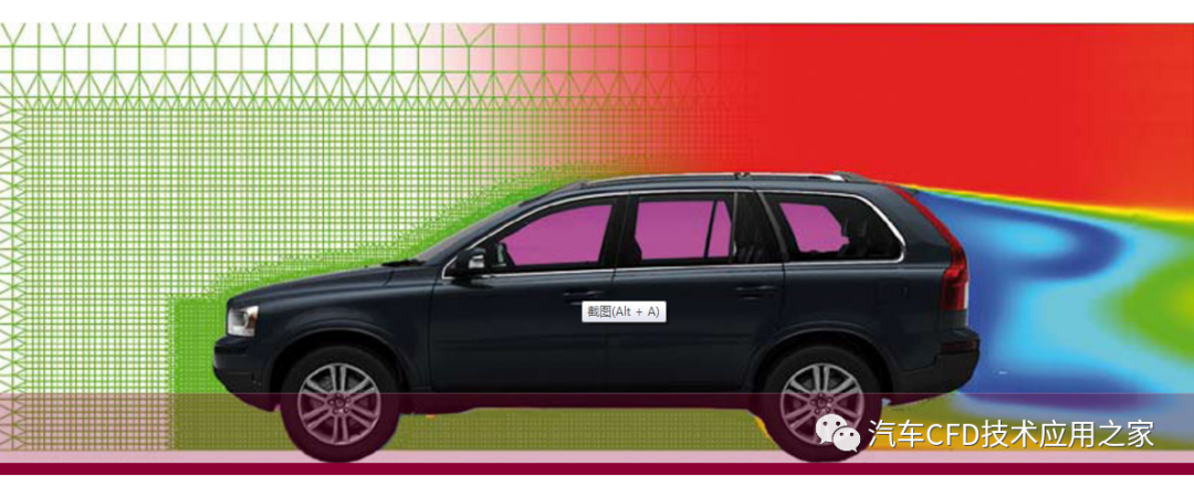

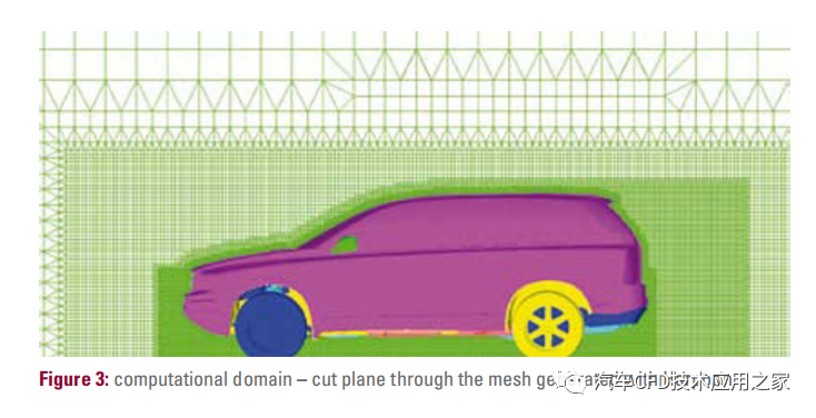

Harpoon was used fort the meshing. Harpoon is an octree mesher that produces a hex-dominant mesh. At the boundaries, the cut cells are converted into pyramids,tetrahedrons, or prisms in order to get the best quality. The computational domain is 50 m x 9.5 m x 9.6 m, Figure 3. For the vehicle structure the edge length is set to 5 mm. Only for critical domains, where separations were expected to occur, for example in the rear and on very fine details such as the bars of the grille, the size is set to 2.5 mm.
The maximum element size for the surrounding volume mesh was set to 320 mm. Around the entire vehicle, a refinement zone with size 40 mm was placed to assure that the cells do not grow too fast away from the surface. Mesh refinements were placed in the rear (20 mm), under the car (10 mm) and around the cooling package, to capture the wake, to resolve the narrow area to the ground, and to assure a constant mesh size within the cooling components (radiator, condenser, and charge air cooler).
The transition between differently dimensioned hex-zones was maintained by pyramids.
It is a conformal mesh, which means that transitions between two sizes of hexahedra are maintained by pyramids (conformal mesh). The final mesh consists of approximately 30 million cells and takes less than two hours to generate on a computer HP C8000.

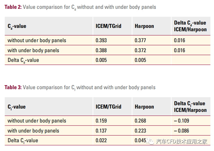

4.1 Effects of Under Body Panels
For both calculated variants (without/with UBP) the Cd values of the Harpoon mesh are by 0.016 below that ones of the ICEM-CFD/TGrid mesh. The difference of the Cd values between UBP and no UBP is 0.005 for both meshes, see Table 2.

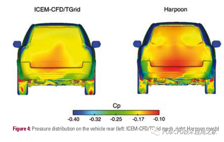

Bigger differences are visible at the clvalues, Table 3. In comparison to the testing results, both meshes predict the front lift too low and rear lift, Figure 4too high. The cl values for the Harpoon mesh are higher (0.109 without UBP, 0.086 with UBP). Even the difference with/without UBP is bigger for the Harpoon mesh. Responsible is the increase of rear lift.

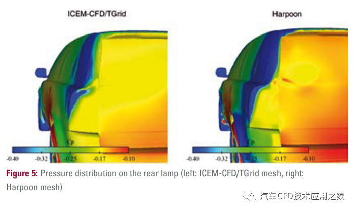

For the Harpoon mesh the pressure for the variant without UBP is slightly higher all over the base area. There is a larger region of low pressure on the rear lamp, Figure 5, for the ICEM-CFD/TGrid mesh compared to the Harpoon mesh. This indicates that separation occurs further downstream for the mesh made with ICEM-CFD/TGrid. Comparing to test results made in wind tunnel, the separation line for the Harpoon mesh looks more realistic.

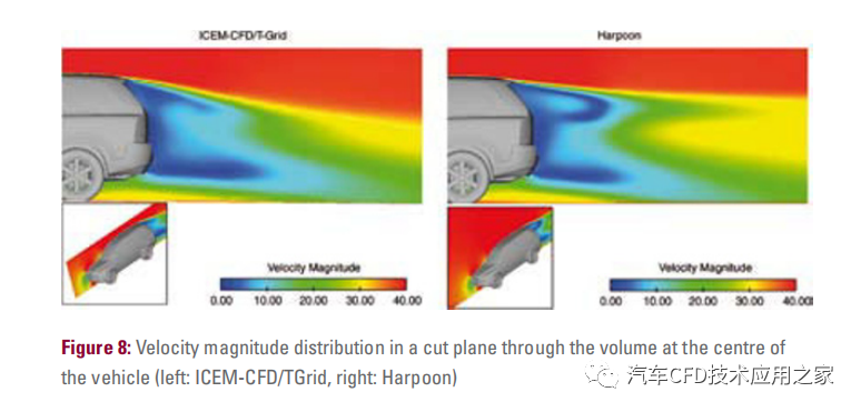

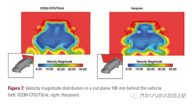

Because of the difference in separation in the rear, the wake structure is different. The bottom half looks the same for the two meshes. But on the top, the Harpoon mesh looks more irregular. A possible explanation is a vortex that is formed over the cat walk, which is stronger for the Harpoon mesh.Areas with a relative high pressure on the rear side of the front wheels, Figure 6lower the Cd value in the Harpoon mesh. The part of the total Cd value that comes from the front wheels is 0.05 for the ICEMCFD/TGrid mesh and 0.03 for the Harpoon mesh. One reason for this difference could be the coarse mesh around the wheels in the Harpoon mesh. The y+-values (optimum 30–100) have an average of 200 significantly higher than fo the ICEM-CFD/TGrid mesh.

传统上,沃尔沃汽车使用两个网格划分程序。ICEM-CFD用于上半身的八叉树网格, TGrid用于身体下方的非结构化Delaunay网格。今天,网格化是用CEI的鱼叉完成的,CEI是一种八叉树网格器,它产生一个以六角为主的网格。为了评估两种不同网格对仿真结果的影响,计算了SUV Volvo XC 90的两种变体(带和不带车身下面板(UBP),图2)。 这是一款带有后视镜、完全详细的车身、相当详细的发动机部件和开放式轮辋的外部车型。

2.2 CAD 数据清理
对于CAD数据的清理 - 简单检查,去除间隙和交叉点 - 根据模块的内容使用不同的方法通过使用面部包装可以节省最大的时间。使用这种方法,使用曲面网格收缩基础几何体。 孔将被关闭,交叉点将被移除,如果需要,可以移除几何细节。从理论上讲,整个模型可以通过表面缠绕生成。 实际上,网格变得太大,并且在Ansa中无法很好地处理众多表面。通常,使用表面包装和手动编辑的混合方式表1
– 车身/外观:使用Ansa手动关闭外表面不必要的细节并关闭间隙。
– 前后底盘、发动机车轮:通过表面包装进行简化和校正。CD-Adapco 的包装器通过拟合脚本以批处理方式执行
– 在车身下:产生连续镶嵌表面。基于Catia V5中新表面的构造。数百个表面减少到十个。
– 冷却系统:由热力学CFD团队手动清理。

鱼叉用于网格。Harpoon是一种八叉树网格,可产生以六角为主的网格。在边界处,切割的单元格被转换为金字塔,四面体或棱镜,以获得最佳质量。计算主图为50 m x 9.5 m x 9.6 m,图3。对于车辆结构,边缘长度设置为 5 mm。仅对于预计会发生分离的关键区域,例如在后部和非常精细的细节(例如格栅的杆)上,尺寸设置为 2.5 毫米。
周围体积网格的最大单元尺寸设置为320 mm。 在整个车辆周围放置了一个尺寸为40 mm的细化区,以确保细胞不会在远离表面的地方生长得太快。网格细化放置在后部(20 mm),汽车下方(10 mm)和冷却组件周围,以捕获尾流将狭窄区域解析到地面,并确保冷却组件(散热器,冷凝器和增压空气冷却器)的网格尺寸恒定
金字塔维持了不同尺寸的六角区之间的过渡
它是一个共形网格,这意味着两种尺寸的六面体之间的过渡由金字塔共形网格)保持。最终的网格单元包含大约 30 万个单元,在计算机 HP C8000 上生成所需的时间不到两个小时

对于两个计算变体(没有/有UBP),鱼叉网格的C d值比ICEM-CFD/TGrid网格的C d低0.016对于两个网格,UBP 和无 UBP 之间的 Cd 值之差为 0.005,请参见表 2

在表 3 的 c l 值处可以看到更大的差异。与测试结果相比两个网格都预测前升力太低,后升力图 4)太高。 鱼叉网格的 c l 值更高(不使用 UBP 时为 0.109,使用 UBP 时为 0.086)。即使有/没有UBP的差异对于Harpoon网格来说也更大。负责增加后升力。

对于鱼叉网,没有UBP的变体在整个基部区域的压力略高。鱼叉网相比ICEM-CFD/TGrid网的上的低压区域更大如图5所示。这表明用ICEM-CFD/TGrid制成的网格在下游发生分离。与在风洞中进行的测试结果相比,鱼叉网的分离线看起来更逼真。

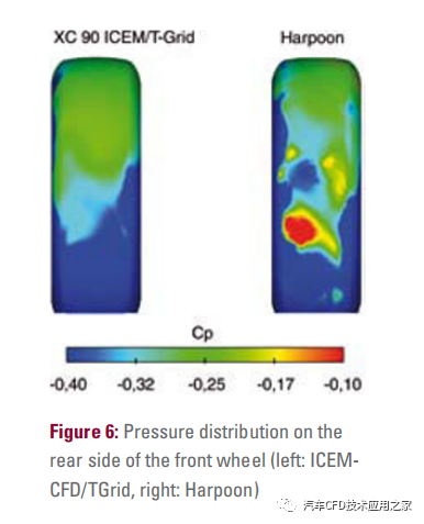

由于后部的分离不同,尾流结构是不同的。两个网格的下半部分看起来相同。但在顶部,鱼叉网看起来更不规则。一种可能的解释是在猫走道上形成的漩涡,这对于鱼叉网来说更强。前轮后侧压力相对较高的区域图 6降低鱼叉网格中的 d 值。来自前轮的总Cd的一部分对于ICEMCFD / TGrid网格为0.05,对于鱼叉网格为0.03。造成这种差异的原因之一可能是鱼叉网格中车轮周围的粗网格。y+值(最佳30–100)的平均年龄为200,明显高于ICEM-CFD/TGrid网格。
