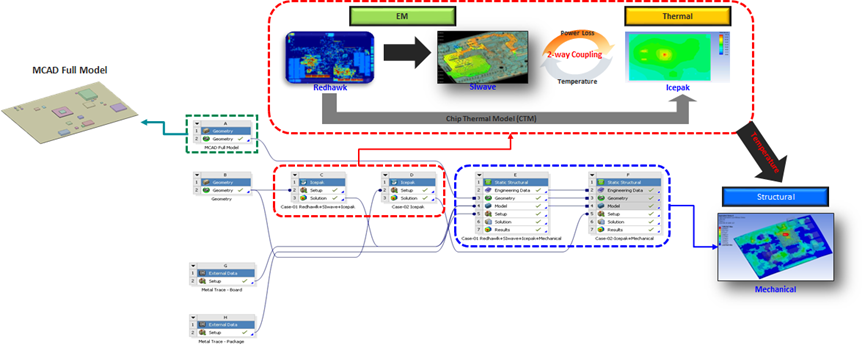

Ansys电-热-力解决方案介绍
Ansys Multiphysics Technologies for Electronic Systems Reliability
终端仿真环境多场耦合结构可靠性设计的图3
Electro-Thermal Solutions
-Thermal analysis is tightly integrated with ANSYS’s Electromagnetic (EM) solvers

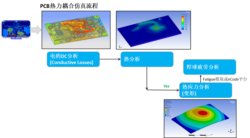

Ansys电-热-力仿真案例

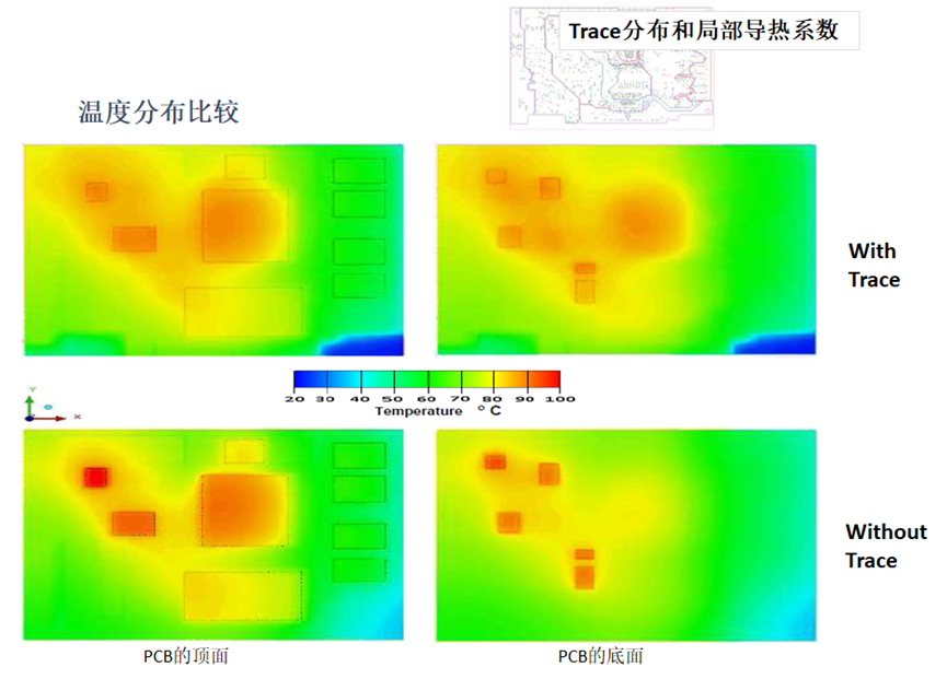

手机中PCB热力可靠性分析

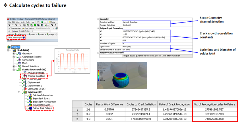

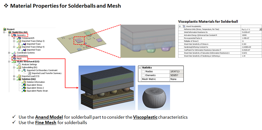

Stress and Strain Analysis of Solderball
