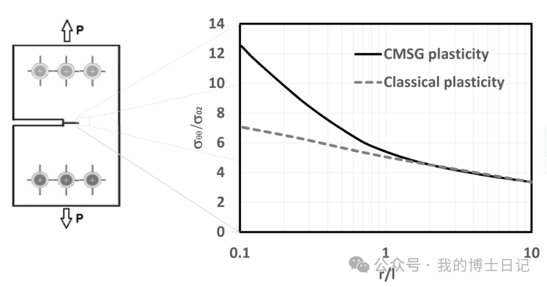

适用于ansys的应变梯度塑性本构(CMSG)子程序(开源资源)
适用于ansys的应变梯度塑性本构(CMSG)子程序(开源资源)的图1

c     The conventional theory of mechanism-based strain gradient plasticity model
c     If you use this code for research or industrial purposes, please cite:
c       V. Shlyannikov, E. Martinez-Paneda, A. Tumanov, A. Tartygasheva,
c       Crack tip fields and fracture resistance parameters based on strain gradient plasticity,
c       International Journal of Solids and Structures, Volumes 208–209, 2021, Pages 63-82
c     https://doi.org/10.1016/j.ijsolstr.2020.10.015
