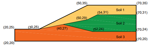

newmodel()set("failureDir","r2l")extboundary(20,25,30,25,50,35,70,35,70,20,20,20,20,25)matboundary(30,25,50,29,54,31,70,31)matboundary(40,27,52,24,70,24)definemat("ground","matID",1,"matName","Soil 1","uw",19.5,"cohesion",0,"friction",38)definemat("ground","matID",2,"matName","Soil 2","uw",19.5,"cohesion",5.3,"friction",23)definemat("ground","matID",3,"matName","Soil 3","uw",19.5,"cohesion",7.2,"friction",20)assignsoilmat("matid",1,"atpoint",53.5982,32.8461)assignsoilmat("matid",2,"atpoint",56.9309,28.517)assignsoilmat("matid",3,"atpoint",34.2547,22.0234)definelimits("limit",20,36.665,"limit2",45,70)compute()
这段代码用来计算下图所示的边坡稳定性。在这个开放的设计框架中,用户可以用JavaScript语言写子程序来扩展程序现有的功能,包括设计自己的用户界面。

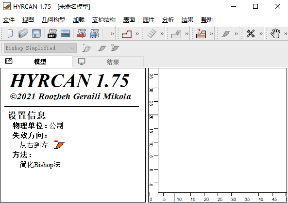

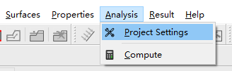

(1) 第一次打开程序后,用户界面语言是英语,如果有些同学感觉英语看起来吃力,点击如下所示的菜单,选择”Simplified Chinese”, 然后按”Apply”按钮,程序界面就会转变成中文。HYRCAN允许用户使用多语言的用户界面,并且可以随时切换和改进界面。
