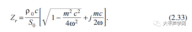

   The radiation impedance of an exponential horn, assumed to be infinitely long for our purposes, is
关于指数号筒的辐射阻抗和截止频率计算的图3
   The first term in the brackets is the radiation resistance, and the second is the radiation reactance. Of interest is the frequency at which the value of expression inside the square root becomes zero
关于指数号筒的辐射阻抗和截止频率计算的图4
   This is known as the horn cutoff frequency. The above theory predicts that no sound will be transmitted through the horn below this frequency. Clearly, this is not the case with real horns, so the theory contains one or more assumptions that are not met in practice. Note also that the second term in the brackets, the radiation reactance, goes to zero in the high-frequency limit.
